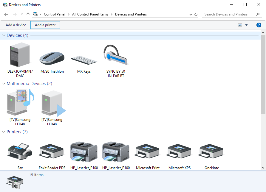

  2. Now we need to add a Printer in Windows 10. Click on Devices and Printers in Control Panel. This should bring up the following window:
    Setting up on Windows

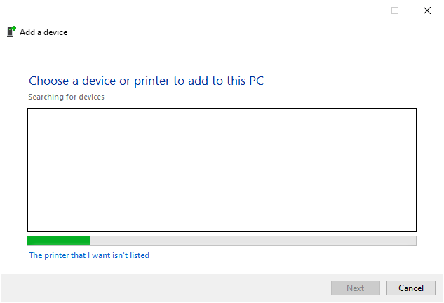

    If your printer is listed after the search is complete, select it and finish the installation process. However, if like me the window shows No device found after the search, click on “The printer that I want isn’t listed” and it will bring up the following window:
