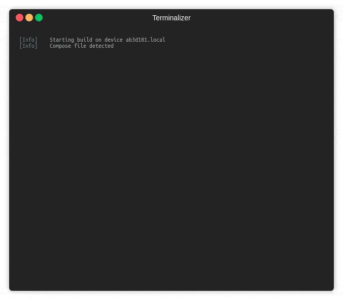

Local mode
The first step in our mission to deliver a better user experience was finding a way to reduce the time between code changing and it running on your device. We already had the command balena local push, but this feature lived in isolation, it didn’t support multi-container, and was difficult to update. We decided to scrap the existing workflow and instead use the supervisor, as the container orchestration code already existed and now the supervisor was part of balenaOS in both managed and unmanaged devices. Note that local mode is only supported on .dev variants of balenaOS and on balena cloud it needs to be explicitly enabled.
To perform a local mode push, in your project directory, execute balena push <device-ip> or balena push <short-uuid>.local. This will attempt to communicate with the supervisor and docker daemon on the target device, which will detect information about your device, and resolve any Dockerfile.template files. The builds will then occur on-device. Note, this may be slower for the first push than using the cloud builder (in general), but subsequent pushes will make use of docker layer caching, and will be much faster.
Once the builds have completed, a target state is generated, in much the same way as balenaCloud. The supervisor then applies this target state, and your code will be running!
local mode gif
